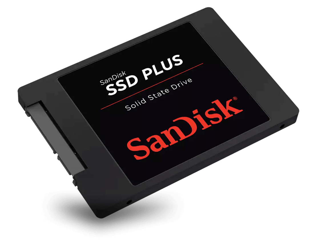

  • Insert your 2.5” SATA SSD into the USB to SATA III adapter.
  • Connect the adapter to your laptop via USB.
  • Use Acronis True Image for Sandisk to create an exact copy of your current hard disk boot drive onto the new SSD.

  • Disconnect the HDD from the SATA and power connectors.
  • Carefully remove the HDD from the bay.
STEP 5
Install the SSD
  • Insert the new 2.5” SATA SSD into the same slot.
  • Connect the SSD to the computer’s SATA and power connectors.
  • Secure it with screws and ensure it is firmly connected.
